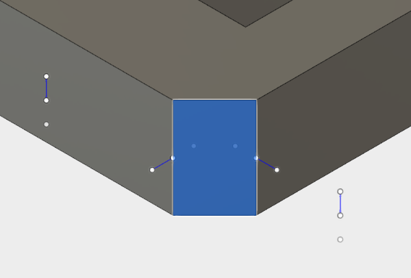

Something else that i've encountered is that BRepEdge.pointOnEdge doesn't always give me a point that is actually on the edge - which is in contrast to what the help page states. In this case the selected face was the product of a chamfer.
PrQBxkf

Here's the action i'm taking in my (python) code:
face = adsk.fusion.BRepFace.cast(selection.entity)
    for loop in face.loops:
      if loop.isOuter:
        for edge in loop.edges:
          sample_point = edge.pointOnEdge
          faces = edge.faces
          assert faces.count == 2
          faces = [f for f in faces if f.tempId != face.tempId]
          assert len(faces) == 1, 'Expected 1 face but found {}.'.format(len(faces))
          (r, norm) = faces[0].geometry.evaluator.getNormalAtPoint(sample_point)
          assert r, 'Failed to get normal'
and, as you can see in my previous image, I get normals that point INTO my body - granted in this case the normal in question is based on a line well off the body geometry but the same artifact happens on any edge adjacent to the "bottom" of the body - those normals always point "up" not "out".
Is this the wrong way to get the evaluator?

You're getting the evaluator from the geometry associated with the face and that's the case where the normal is arbitrary.  Instead of:
You should be doing:
(r, norm) = faces[0].evaluator.getNormalAtPoint(sample_point)
