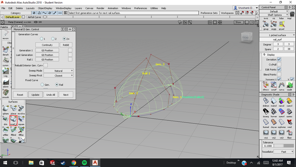

Hi everyone,
I'm trying to recreate what is being done in this video (https://youtu.be/u8gdXDwwL9M?t=920) in Alias. Essentially a cockpit shape is created through the loft command in solidworks by selecting some curves as the profiles (generation curve in Alias) and one curve as the guide (rail curve in Alias). The closest I've gotten is this:
Very obvious problems in the shape can be seen in the start and end of the rail sweep. Another problem is that the screenshot is a "scaled down" version of what we're actually trying to do. In the actual design of our car we intend on have the profile be an imported .csv file that give coordinates of a wingfoil shape and this results in 61 span curves. So even in the simple one we have issues but in the full scale it simply refuses to make the rail sweep because it would result in exceeding the maximum surface spans. Any ideas on how to rebuild a 61 span curve without destroy the shape? With rebuild curve going down to 20 results in a super "blocky" curve. Sorry for the long post by tl;dr:
1) How can we make a proper cockpit rail sweep without the errors in the screenshot?
2) When we figure out how to rail properly how can we properly use a set of coordinates to make a low-span curve in Alias? Using a import CSV plugin results in 50+ span curves that we can't figure out how to rebuild.
I've been bashing my head at this for hours so I'd really appreciate any help! Thanks!

So using Rebuild Curve I got an imported airfoil shape down to 13 spans but it looks super ugly 😕
On the rail side of things, I figure out how to make it a bit better by making sure all my intersections were on the same plane but it still looks messed up at the edges:

Alias works differently than SolidWorks does. You cannot completely copy a workflow to another software and expect the same or better results. Rather you have to adapt a workflow to use the potential of another software. I know, you transferred the loft command to the monorail command, but that obviously isn´t enough.
Things that could help building that surface are:
  • Splitting the guide curves into different curves where each one of these curves follows it´s own kind of flow (constant, accelerating or decelerating)
  • Connecting different curves to fit your purpose of continuity
  • Rather building just one half of the surface (90°) and mirror the other half (to make it your 180° segment) than completely creating all 180° of the surface in one.
I hope that helps a little bit with creating. I can actually just assume, what could be helpful

Basicly there is no problem to use any importet curve in Alias. It depends on how close you want to stay on your input curves. "Bad" input geometry will result in bad model-quality, except you allow the surfaces not to stay 100% in the input curves. Then you will be able to create smooth models even out of crappy curves.
It might sound hard, but it seems you used the rail tool in a totally wrong way.
Sadly i dont have the time atm to write a detailed "manual".
Maybe you could place a screenshot of the shape you want to model (couse i couldnt find it in the video).
Tip, dont let surface corners run into 1 singe point. This almost allways gives bad geometry. It only works for revolves. Try to use Gen1 and Gen2 as rails, forget Gen3 and use Rail1 as profile. Separate the start and endpoints of the new rails and put the ends of the profile curve at the startpoints of your new rails. You can add as much new profile curves as you want along the rails. But rather keep the input geometry in low complexity. Results get better that way.

Surface patches are four-sided.  The shape you are trying to build does not have four obvious sides, so we will need to devise a way to build that shape using four sided patches.  The easiest way is to Trim the four-sided patch to give you something that is not four-sided.  Fortunately, you have the body of the car with which we can Intersect the canopy surface.
Below is just one method; the fastest and easiest, I think.  Everything is done by directly moving CVs, no Birail or any other surface construction tool.
First we start with the body;  It is abbreviated here, but is a simple default 3x3 Plane shaped by moving some CVs.
Next we build another 3x3 Plane for the canopy surface.
Move CVs to shape it.  You may need to add some Patch Precision to it so that you can better see its shape.
More shaping by moving CVs; this time in the side view.
Shaping in plan view.  If you need a more complex shape, you can increase Degree or even add Spans for more CVs to move around.
A few final tweaks, and it is basically finished.
As you can see, the canopy surface extends beyond the body surface.  You can trim them where the intersect or you can also add a fillet here if you need.

Personally, I would not.  The chances of those imported curves being usable as is, is very low.
If you absolutely MUST maintain those profiles, then you will likely need to rebuild them first.  The shape you are trying to build is rather complex in that it goes from a relatively large radius down to a pinch at the tips; I doubt that the rail tools will be able to interpolate this properly and you will end up having to split the canopy up into multiple patches.
What I would do is the method above, using those imported curves as guides to shape the canopy, increasing the CV count as necessary...concentrating more on making the surface nicely shaped and clean, even if it means deviating a bit from the guides.
