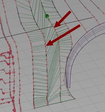

elec86
I am looking for the tool to join surfaces between them (see arrow on photo)
these surfaces were made with the skin tool

Fausto_Brevi
The join surface tool is named Attach and it's located in ObjectEdit menu of the Palette, but I guess you should totally rethink your current way to build surfaces in Alias.
