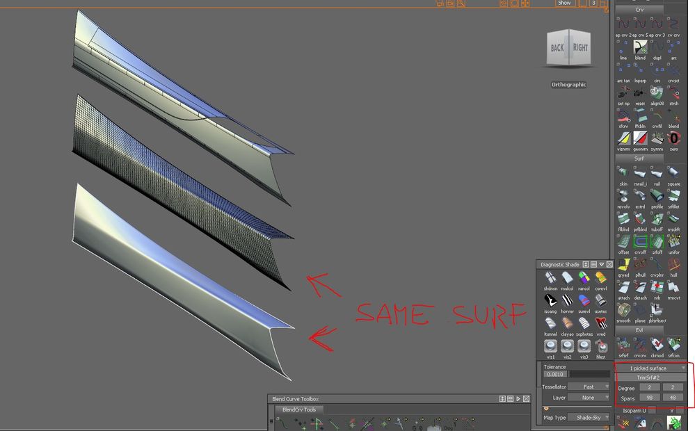

there is a strange surface, a single surface like a remapping of doorpanel, that used for create a pattern in dynamo.
how can create this kind of surface ?
i think is has made with autodesk softwares… i hope
i think it’s not possibile to create in alias software … if possibile, teach me !
surf cv.JPGsurf.JPGplease help me!

hi !
the left surface it’s not a mesh, it’s a single surface with degree 3x3 and many span, that recalc almost perfectly the original surfaces made in alias .
i would like to learn how can i create this kind of surface
in attach
1 original alias surfaces
2 single surface with isoparam
