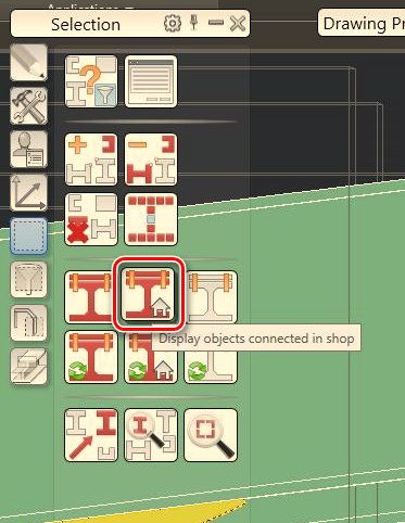

It would be really helpful if, after creating a weld in the model, you could click on the weld and know which pieces are being welded together via that weld. There are many times where I have edited my model and then I have weld symbols scattered that I do not know which pieces they belonged to.

Nevertheless, one can make this.
Select the weld and then click on the function "display objects connected in shop".
