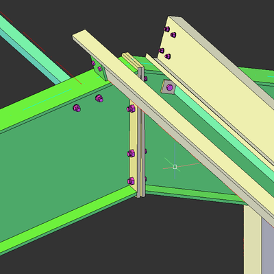

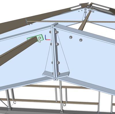

The tapered beams presentation in an IFC file is incorrect. The cuts on the beams aren't exported to the IFC files. This is going on for a long time now. Can't find a earlier topic for this, so here is mine. Please solve this? This is sloppy to send to clients.
1 Kommentar
AntDrt
confirmed there is a bug,
not only on IFC
SDNF too.
CIS/2 fabrication seems to be good
