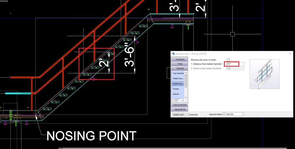

Nosing point and heights work when a nosing point is selected, mid-rail distance works when selected "from bottom",  probably there is a confusion when measuring distance between top rail and mid-rail, if set to "measure from top", for some reason the distance does not match the values for both horizontal and sloped handrails. Ref screen shot below, mid-rail to top rail is supposed to be 1'-10, but it is 2'-0 at horizontal and 2'-0 1/2" at sloped handrail. I hope I am not missing something, I updated the joint, and the mid-rail stays at 2'-0 from top. Thank you. Ilko Dimitrov, ACBS
Mid-rail height selected from topMid-rail height selected from top

acbsdesign
@DumitruBerteanu
Please see the two screen shots below, railing heights do not always work when creating with Nosing Point selected.
Hight does not match the nosing point locationHight does not match the nosing point locationMid-rail height does not match nosing point locationMid-rail height does not match nosing point location
