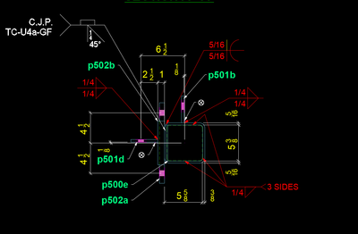

And another reason why I prefer the typical weld details-Not all AS intelligent connections are perfectly done with all possible weld combinations.
Here is one example:
The Tale of the symbol in red does not meet AWS standards.
I am positively sure if I have to use AS default  weld symbol for TC-U4a-GF would not look any closer than the symbol above.
Here is what dev's invented-red vs white:
I don't know a single person who would prefer the symbol in red vs the symbol in white.
Or may be I don't know enough.
