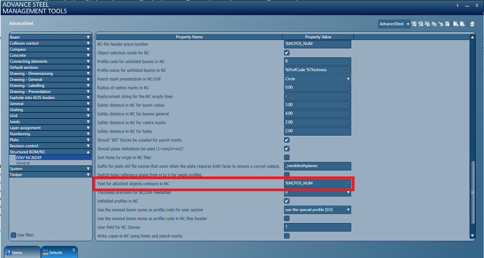

This has come from a customer of ours
What they require is an NC file for plates, they want the outline etching of attached parts in NC files, but they dont want the text for the attached parts
There is an option in Management Defaults for "Text for attached objects in NC" we have tried to fudge this by setting the value to "%" (its not possible to have it blank)
If we set the value to "%" the NC file does run but there is still a line in the NC file for the SI block. There machine still wants to do some kind of etching
