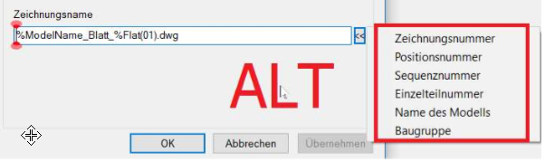

At the moment one can use only following variables in the drawing name:
Drawing number, position number, sequence number, single part number, model name and assembly.
It would be much more comfortable if one could insert there also the data from the project data as a variable, e.g., project name and project number.

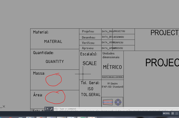

In our company we put (need) the the mass (weight and area) of assemblies and parts on the titleblock, for (if needed) construction, logistics and quotations, very handy indeed. we also deliver it on documentations list (seperated FULL/all BOM lists of the project).
Example:
But i can't find any mass or area token for the titleblock.
Autodesk is it possible to ad these tokens in near future?

cjuliao
I have that page printed (png file) and on my desktop to gather the information faster, but unfortanly no weight and area  :(, at least not yet.

The "Project number" token is working in the Drawing Process - Filename selector, among other tokens from "Project data", including Project user attributes.
Please see this article:
Many thanks to @nial.ball for push and for testing :leicht_lächelndes_Gesicht:

It is true that some variables have been working in the FilenameSelector since version 2020, but these variables do not appear in the selection list for the FilenameSelector. Most of the variables from the project data can be used in this way. However, the FilenameSelector cannot be extended indefinitely with variables. The database table only allows a maximum of 64 characters. In addition, since many users do not know how to get the correct designation of the variables, it would make sense to supplement this selection list with the possible variables and to issue a warning message if the FilenameSelector becomes too long.
