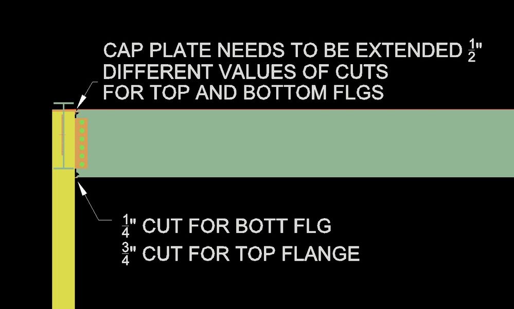

Moment connection macro:
Based on the welding procedure to be used, we need to cut top and bottom flanges with different values in order to achieve the required gap between welded elements.
Currently the moment connections macro has the option to cut the web with a different value, but it cuts both top and bottom flanges with the same value.
We usually explode the macro to be able to move one flange cut keeping the other as it is done by the macro.
It would be helpful if we had an option to cut top and bottom flanges with different values.
This is very common moment connection.
