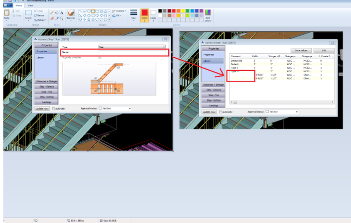

Hi Group,
I was wondering if at any time in any version of Advance Steel has the name box available in most macros been automatically transferred to its library comment field when saving the configuration of the macro to it's library?
If it has in the past it is not working now.
If it never did it should automatically populate the comment box with the user created name in the library so that you can kill two birds with one click.
I'm not aware of any other way to populate the library comment box other than having to open the library and manually click in the box and then type a description after you save the custom config. of the macro which adds to the massive amount of unnecessary mouse clicks "featured" in Advance Steel which need to be purged from the program to enhance productivity, not to mention the fact that none of the columns in the library will resize to text so you wind up having to fart around with the column borders with extra mouse activity.....so many time wasting mouse operations add up bigtime at the end of the day.
See attached pic.
Regards
Craig
