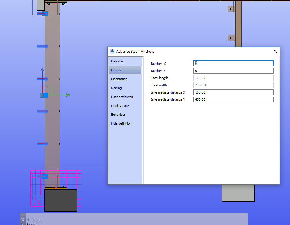

We have had a query from a client, please see description below
A column have a group of anchors inserted in the flange, there are 6 anchors vertically at 450mm vertical centres, these have been inserted as 1 group of anchors.
When the camera has been created to show the base detail the anchors do not show becuase the camera does not cover the whole group of anchors.
The 2 options at the moment are to "Split the bolts group" or create 6 seperate groups of anchors, both of these workarounds will produce more labels on the fabrication drawingsAnchor spacings.pngCamera extents.PNGDrawing result.PNG
