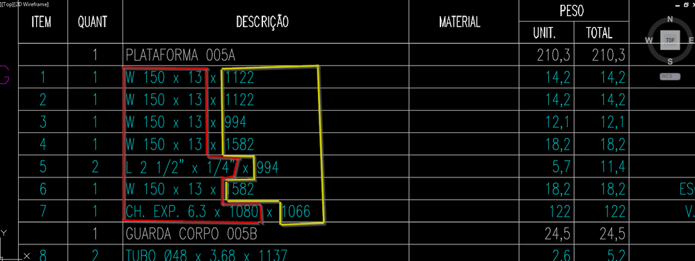

It would be very important features to create LM in advanced drawing. So that we can customize the LM according to the taste of the client.
Many of our customers the LM have a total weight of the sets before the listing of the items and I was not able to enter this information automatically.
Example:
2017-10-30 11_06_24-Autodesk Advance Steel 2018 - [PAX-PIM-DF-104-005-RA.dwg].png
Another very important feature would be to concatenate texts, for example, concatenate the profile name with the length or the name of the set with the mark. I could not do this either using the tolkens directly, or using the VBScrip feature, which does not seem to work in LMs which would be very useful.

Hi Autodesk,
This would be very important for us because our customers need to customize their BOM from different ways.
We would be glad if the Autodesk implement this feature in the upcoming update.
