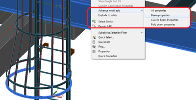

Advance steel selection is type dependend. If you have a mix of types in your selection, you do not have access to Advance Steel properties. Advance Steel should use the first part selected as a type filter. If you select a straight beam first and then other objects, you should have access to the properties of all straight beams in the selection and this way be able to edit them with one command.

Thanks Christian for sharing this request.
It sounds like the "Multi-Edit" under the RMB doesn't satsify your needs (see below). It would be great if you could kindly let me know more details around your requirement and why the "Multi-Edit" is not sufficient.
