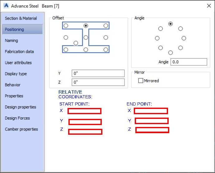

4. Added functionality: Manipulate system ends by entering values in AS properties.
Example-we need to move end of a beam 6" along its X -Axis-enter +6" in properties, or add 6" to the current value of X
Another example-Move lower end of a column by just modifying the ordinate value.
4-cont........Added functionality: Manipulate system ends by entering values in AS properties..........Added-palette, separate from AS Properties.
Probably a better way to do this would be a separate macro, not connected to Advance Properties,
to be started with a right click from the default menu.
A separate palette where we can modify ordinates:
Option-Relative or Absilute UCS
Moving the MIDPOINT to move the entire beam / column.
Moving start or end point to behave same as we drag the system end manually-connections to stay intelligent-such as base plates, cap (end) plates, clips, shear plates.
Checkbox "absolute" or "relative" to trigger current values to be displayed.
Coordinates may be used either when building a beam or column, or to move start point or end point due to design changes. Or moving the entire beam or column by changing the values of coordinates simultaneously. As the AS object is an AutoCad object having system line to behave similar to Autocad line.
Coordinates should have absolute and relative values in this dialog window, both to be manipulated.
This will be huge timesaver for columns for example.
