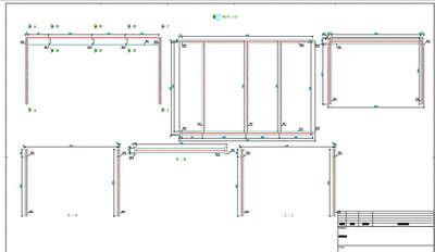

I've had this issue with welded frames (a simple four post welded stair landing) for a while now and thought I had it beat.... I was wrong.
I want to create simple views of four post frames complete with a cut list on the same page, or at least a separate parts sheet of all the cut items. These drawings should be Top, Front, and End view.
2D AutoCAD drawing below as an example:
So I created a new drawing style with views at Object Front, Object Top, and Object Right Side.
This all works well, but only sometimes.
This is what I get sometimes, the front view is the top, side view not at all what I want. What Advance seems to want to define as front or top isn't always what I want OR what I've told it to be via set assembly detailing direction and what the Assembly CS shows as.
I seem to be having intermittent issues of the Assembly CS not translating into the right views being generated and I can't figure out why.  I've tried changing the main part of the assembly, and had that work... sometimes.

s_hannemann
i am doing similar things and have no troubles at all. Maybe u share a model which troubles u and we can have a look?
What my drawing style often looks like is Front, Top, Side View and Cut Views. They depend all on the main part coordinate system. Sometimes the numbering process isnt arranging the coordinate system right, so i change it manually. I cant find the screencast download anymore so i cant share a drawing of a simple steel structure, unfortunately.

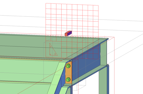

I seem to be struggling with main parts and "Create part Assembly" as if I try and change the main part after creating my part assembly the box around it disappears and I need to define things again.
Even then there seems to be issues where the drawings created aren't showing the front view that object CS tells me I should have.
If I try this with a simple frame I don't seem to have any issues. Working with a frame that is a landing for stairs and I have problems.  I'll try and present the object from different angles that make the most sense from a detailing and drawing layout perspective.
Assembly CS:
Drawing result. Not what I want, plan view should be top, front view below, end view to the side with all legs pointed down.

bigcarl5000kg
And the fun begins ... for an already numbered model, make a test - change CS for main part, make drawing ... at some later time you reset the numbering (MP / SP / ...) and voila ... CS returns to its original state ... and you are at the beginning
+++ impossible immediately and miracles within 3 days +++
+++ the only constant is the change +++ stay tuned for more +++
+++ since 03/2023 is Advance Steel in maintenance mode, no further development +++

bigcarl5000kg
In case you perform the numbering incorrectly and reset even once... the changed CS are gone... and that I made a lot of trouble with it ... until today, despite the experience, there is simply no way around it

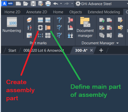

Drawtech
@Garret_H
As others have eluded to, I think the problem here is using "Create Assembly Part" and it doesn't work as it should.
I never use "Create Assembly Part" and I never have any issues with this type of assembly.
However, to do so you would need to make some compromises on your preferred numbering.
Either:
1. Still use "SP No (for Main part) = assembly number " but accept that similar parts to the main part will have a different number.
Or
2. Use one of the other numbering options (I use "SP No (for Standalone part) = Assembly No") and then if other parts are similar to your main part they will still get the same single part number.
You can still manually set which part is the main part (but is the heaviest part by default).
Maybe you know all this already, but I think it would save you a lot of headaches by avoiding "Create Assembly Part" completely!

Sebastian_Eiche
I could confirm what @bigcarl5000kg already told. The CS will be changed in a few situations.
For some I could understand why but not in all.
  • by using the "delete numbers" the numbers will be deleted, but the information which is the mainpart is existing (could be tested) --> so why is the CS set to the original?
  • handrails: one numbered and CS changed to the one I want. Now i change the handrail in some details of the structural element and so the elements will be "recreated". Now the CS is set back, and this is something I understand.
From my experience: I often try to avoid to use this command by using the "define as mainpart" button
