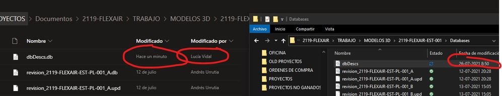

colleagues,
I have a problem. I've updated the drawings but all the steel elements have dissapear. there are still showing the axis and dimension... but the steel elements have dissapear.
is there any option to solve this issue?

no, I haven't try... the odd stuff is that this db file is being always updating (the first one)

No, I can´t upload the files because the dbdescs is constantly being updated and there is no way to compress it.
I begun working with the file as shown
then I decided to add some joint cameras, then i move all the views to a second drawing (in the document manager) and finally I upgraded everything.. now I have 2 drawings empty but the model is recognized by AS because I updated the material list and it is ok.

Sebastian. It seems to be a onedrive problem. my partner load the files from her computer and looks everything fine. there is a lack of synchronization betwen my computer and onedrive server...
"Hace un minuto" means : one minute ago... 15:09
Message 8 of 8
this problem was solved.. finally I restarted windows with the advanced startup options, then I logged in as admin, open the cmd and delete the file (because the right copy was stored in onedrive server). then I restarted windows normally and onedrive restored the file from the server. now the drawings are ready to be delivered. thank you anyway
