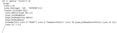

Message 8 of 8
I just found this topic recently. It's really pretty simple. Just create a lisp command that marks the start ends of the beams. You can apply these to all selected beams in one command. Here is a sample code. In this code I used nodes to show the beam start point.
