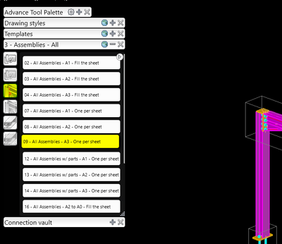

I made changes in the A3 prototypes,I saved and ATTSYC them.
when I used the drawing process to produce the drawings:
and I click on the assemblies and the parts like in the image , it makes the drawings with my prototype.
but when I choose selected assemblies or parts:
, it uses different prototype, why?
and how can I change it to my prototype?
thank you

A prototype reference, it’s name including the dwg reference is typically placed under the file name selector part of the drawing processes, within the main step of the required process.
I would check there first of all what the existing prototype reference is.
also it may depend upon if you are using the main prototype files from the advance steel folder or you are using them under the project, in another thread I think you where pointed in that direction.

if useing a process the prototype is set in
see pic
process manager/ user/drawing process/detail drawings/click box
then change the prototype by changing last circled bit change to the file name of the one u wont
