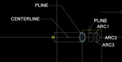

I am creating nc/dxf files for model objects and I am getting a very strange result for sloped handrail posts.
I have attached a screen shot of the model objects, a screenshot of the .nc1 file in a third party viewer, and the dxf file created of the same part.  My ultimate goal is to send this profile to our 5 axis plasma table and cut the handrail posts from 1/2" plate.  This is no problem for horizontal handrail, but get some "jagged" features with sloped handrail.  I am far from an expert with NC language, but is there something I can do to clean this up?  Can anyone explain why this is happening?
Thanks in advance.

Hi @daniel.tarnowski ,
the problem starts already in the model - it's all about the representation of such sloped hole / machining. This is big problem in Advance Steel - how did you make the hole? Manually or with some tool?

I'm not sure I understand your questions.  From a modeling standpoint, the feature was created using a contour processing. (Features-Element Contour Rule or Element Contour)  From the screenshot I provided, I believe it depicts what I am trying to accomplish.
Perhaps a better example is if the handrail was horizontal or perpendicular to the HR post, the cut out shape would be a simple portion of a circle.  (Half circle, quarter circle...)  Both a NC and dxf file for these outputs fine for cutting the HR post out of plate using a cnc plasma table.
When the handrail is not perpendicular to the HR post, there is a bevel cut involved.  It is this bevel cut I am trying to accomplish.  We have a 5 axis plasma head on out table.  Both the NC file as well as the dxf are coming out funny when there is this beveled cut involved.
Does this make sense to you?

@daniel.tarnowski
This is not a big issue for tiny gaps that are not visible (unwelded and architecturally exposed).
Depending on the machine, you may be able to use the NC file and modify it from there, but if  the CNC operator is not cooperating, add the cuts manually using the copy with adjustment or just copy the manually done contour cut.

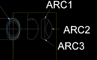

1.  Create a tiny model view with a depth equal to the post thickness, place on post first
2. The real cut without bevel will be very close to an ellipse.
But since ellipse is not a polyline, we will need to build a polyline that is close to it, made of arcs and one line
Have one dimension from the very top of the cut to the bottom.
Midpoint of this dimension will be your centerline
3. Build one temporary ellipse, enter to end point of axis and the other axis.
Move 2-3 inches and build the real polyline -3 arcs and one line

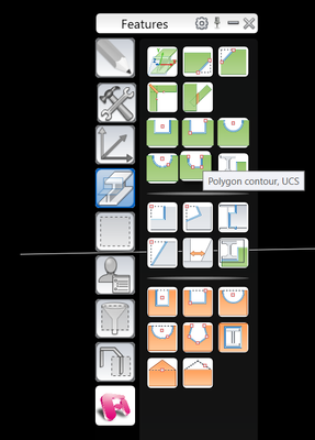

4. Then move the real polyline back and use Polygon Contour UCS
and press P
and select the polyline
The result will be a nice cut normal to the surface, with a minimum of PJP welding at each end.
I know it takes time, but nothing is perfect and sometimes we need to put in more effort than anticipated.
Copy with Copy with Adjustments using the post as a reference or using the Advance Copy, this is seconds of work.
Also-it can be done with a custom connection for all locations having the same slope.
Sometimes we would offset the polyline 1/16” to enlarge the cut further but it depends on the situation.
Done this workaround many times and it is working fine.
Have a great weekend.
