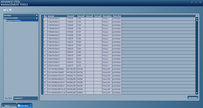

I've recently had to updated MapInternToExtern to show the mectric equilavent of all ASTM shapes but something strange has happened and I cannot figure it out.

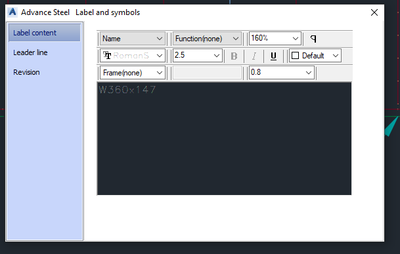

Typically when a member is labeled if "Name" is used it will label the member with the internal name and if I want something different I change it to External 1, or 2, etc.
However after adding all the ASTM shapes whenever a member is labeled with "Name" it defaults to External 1.
I cannot figure out what's going on.
Here you can see the W14x99 with the corresponding Metric names
Here you can see the member label is set to "Name" buts not using Internal 1
Here I've set it to "External 1"
Just to show the mapping is working I've set it to "External 2" to show the short name

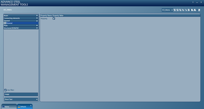

Hi @Jonathan3891,
Thank you for posting on Advance Steel Forum 🙂
I understand that you added mapping rules for profile names. For example, the profile "W14x99" is mapped to "W360x147" from the "External1" field.
Then this is the "Name" that you get in details. It is the intended behavior, the purpose of the mapping.
It seems that you would want mapping for a project, but not for another project.
Is it so?
If you want to get the AISC section name, one option is to deactivate the mapping entirely when working on a project were you do not want mapping.
(deactivate the default from Management Tools -> Defaults -> General -> General category).
Would that work for you?

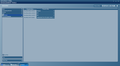

Here's a link to an article on mapping plates (beams are similar).
https://www.autodesk.com/support/technical/article/caas/tsarticles/ts/64Y4V49jeiUnXKsBMvPpaz.html
We use mapping a lot to define a plate name. For example, when using material "RUBBER" on a plate, the material list will call up a plate as 100x10RUBBER and so on...
Then you enable the recoding for material in the defaults
It is a very powerful function and you can pretty much call any object whatever you want. Our strategy is limited to using Grades to modify the object name. As Emy indicated, if you map lots of beam types (for example), then this feature would need to be turned on or off unless it's required all the time. In our case, we use to turn "RD" names (round bars used in bracing AG1/2 macro) to "RMS" so they are consistent with Australian libraries.
Would also suggest you add all your mapping settings in the AstorCurrentAddin database to avoid losing when migrating to a new version...

2) The recoding options (in defaults) will tell you what can be mapped. But you can add tokens in the IntExtMapKeyBeam and Plate tables

I use external1 to show short member names. Or in the case of this post, we were using AISC members on a metric job with the metric callout.
Here in the states we show full member names in plan view. If the same member is shown again in elevation a short name is used.
Its important to mention that in order for mapintertoextern to work, you have to enable mapping in management tools > defaults.

Edit the MapInterToExtern in "AstorCurrentAddIn"
Enable mapping in MT
Change your label token from "Name" to whichever "External Name" containts the information needed.
