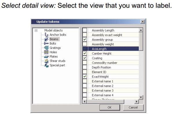

I have a problem to understand - how should work Label Content Manager (_ASTM4CommDetUpdateTokens)!?
Every time I use it, I received a message "All tokens already exist in the detail" (translated from Polish - so maybe not exactly the same in English).
As I understand this command - after selecting detail, then should open window "Update tokens" in which I should be able to select available tokens in the detail:

Hi Bogdan,
Thanks for Your reply - if I understand You correctly, "Label Content Manager" is only for adding missing tokens and not for tokens managing!?
If so... then this tool name is a little prematured and ribbon icon is far too big Smiley Wink.
Anyway... I didn't find any explanation of this tool in Autodesk Advance Steel Help so and in Autodesk Advance Steel User's Guide.
The only place I find explanation of Label Content Manager function was "Advance Steel 2017(2015) - Essentials Metric Training Guide"... but there is written:
"Select the tokens that you want to have available in this drawing detail"
so I understood it, that I can manage about available tokens in the detail and I was probably wrong.
Jerzy

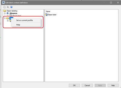

Hello while your reply to why the label content manager is is nice, my question is how do i do it to add custom labels of some kind.

the label content manager is not designed, for creating custom labels. The label manager only manage which token are used from the model.
If you want to create a custom manual label strategy, you had to insert a label and then have a look in the command line...press "C" for change, then right mouse button click on "user" for set this to current profile.
Now you could add any token to any object you want.
These strategies could be changed, if you want to add a complete new one (by not not changing an existing one), you could to this in the management tools.
Open the table editor, open the databases, filter for manual and you will find the "detmanualannotationtyp" table...here you could add a new line and then after restarting AS, you could use the Change Label command again and do whatever you want with this label strategy
