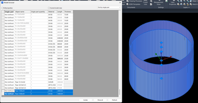

I created an additional pipe section, drew it, and it was displayed in the model.
However, for some reason it suddenly disappeared from the model, and in the model browser it is showing a negative length (-).
Please help me make it visible again.
Thank you.
It was still here on the other day, but suddenly I can’t find it anymore

Sebastian_Eiche
you need to scroll down in the list. Should be in the end...it's sorted by name and the name is 5180x...

votuananhvungtau
It is not a solution. I have scroll down in the list carefully.
The AS manament tools, table editor (microsoft database), I have add lot of pipe sections, and update default for database, but now they are not showed on the item properties
votuananhvungtau
I don't know the reason with Korea Pipe data base, it is created but can not choosen in beam properties
I just try with ICHA Chile pipe database and it is worked normally
