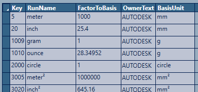

Unit 3 no longer exist. Now for mm it's 5. So your string should be like [ 5, 3, 1]
5
3
1
Hope this help

Just noticed the issue, the values must be placed before the token after the %, like this:
PL %Thicknessx%[5,3,1]Widthx%[5,3,1]Length
As example, mine is : PL %Thicknessx%[20,5006,474]Width"x%Length  for (inches, fractional, 1/16" precision)

Thank you for good observation regarding the position. In my case, for millimeters, without decimals, it works PL %Thicknessx%[3,3,1]Widthx%[3,3,1]Length.
