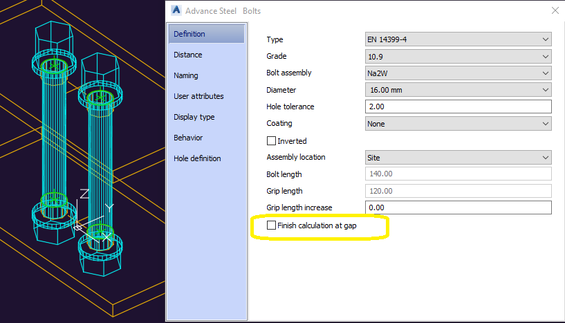

I created custom connections as shown in the picture attached.  The left shows the inserted custom connection with the bolt with the correct grip the right shows the bolt with an incorrect grip.  The original connection drawing shows both with the correct grip but when inserted it doesn't adjust to the correct grip/bolt length.  What am I missing here?image.png.

If bolts connect the parts that you selected depends (among other things like does the projection of your insertion point hit the part) on the settings for the allowed gap between parts. Also the insertion is working from part to connected part.
THe standard setting for the max gap in management tools is 10mm for the internationla version.
THE 2 plates have a gap of 10 mm in between.
I change the gap to 100. now the parts are not bolted anymore, only one is.
The bolt properties have the setting "finish calculation at gap" which is checked by default. If you uncheck this in this specific sitation, thze bolts connection is no changed, because the gap is always in the direction of the bolt. If You move the bolt to the upper part and uncheck then, the connection gets updated.
So the situations that you most likely have is that some of your connections have a gap below, some above this border.
Try unchecking the setting in your template connection.

Thank you ChristianBlei I was finally able to get back on this and when I changed the maximum gap in grip length calculation that resolved the issue.
