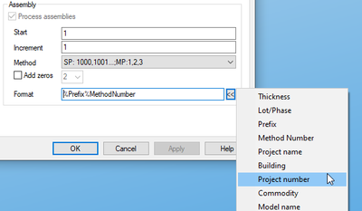

it is posiblle combinated MNum and Project Number? I need create drawing number with project number and Main Number.
I found this: https://www.autodesk.com/support/technical/article/caas/sfdcarticles/sfdcarticles/Custom-Scripts-to-...
And try it in SQL studio, but it not works.
Please can you help me, thanks.

When using the numbering tool you can include the Project Number in the part numbers.
After that whenever the Main Part Number is used it will include the project number too.

When I insert Project number to numbering method.
In drawing label i saw all drawing number, not only mark what I want.
