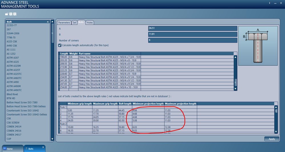

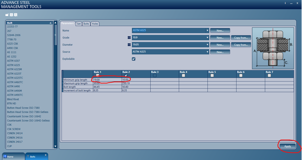

I have tried researching several threads in the forums and I still haven't had success.
I am trying to create the following bolt set in 3/4" diameter:
A325 bolt, F436 Washer, Beveled S Washer, A563 Nut
The photos shown are for a handrail attachment to a channel stringer.  For certain plate thicknesses, the nut doesn't look correct when using a beveled/tapered washer, but looks fine if I change it to NaW or Na2W.
I suspect this has something to do with my rules, and I have tried making some changes to them with no luck.
I have attached two screenshots of what I am talking about, one without the beveled washer and one with.
From what I gather, my minimum length should be: grip + 3/16(F436 washer) + 7/16" (Beveled washer) +1" (A563 nut+1/4")
Any help is greatly appreciated.
Thank you.

Change these values and apply in first image to get positive values in second image.

The thickness at the axis of a 3/4" dia beveled washer is 5/16", Table 7-14 AISC 15th, down on the bottom of the table, it is now a note, not a line in the table as it used to be.
For 3/4" bolt-nut---beveled washer-nut my set up is:
Example:
Bolts through 1" plate:
1+1/8 (roughly) for flat washer+5/16+1=2 7/16"
For 1 1/8" plate:
1 1/8+1/8+5/16+1=2.56"
I hope this helps.

Thank you Ilko for sharing your rule settings for grip length.
I was having a difficult time trying different combinations of parameters as previously suggested.  Just when I found a combination I thought worked, if I changed the base plate thickness in the example I had, certain thicknesses would fail.
I guess I don't fully understand the bolt length calculation rules.
