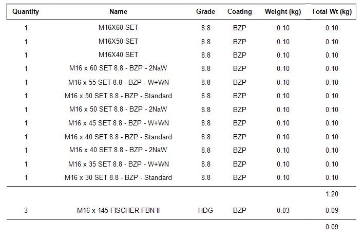

Does anyone know if you can change the names for anchors for BOMs?
If I make the anchor explodable I get the part name I want but also the nut.

For me bolts will always be exploded to keep lists tidier and shorter.
Non exploded.
Exploded.
I didn't know this existed but I like to keep bolt and anchor lists separate so this will work for me.
