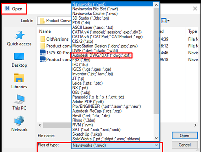

JW_Lotz
Have you tried opening your master file directly from Navisworks?
Message 5 of 15
higginbotham.david
Yes! The master file (.dwg) looks perfect if you open it with Navisworks. But, when you try to export a Dwf or Dwfx manually or with the Export to Navisworks button in Advance Steel. The geometry is of very poor quality. How can I fix this? see snapshots below.
