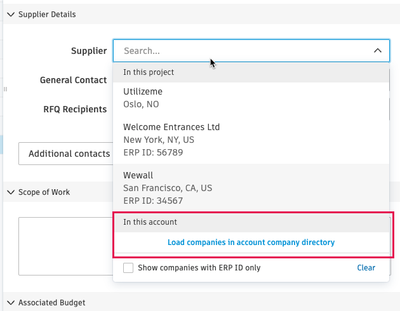

There's no need to add a project member. They just need to be a company in the Account address book!
If the company exists here (Only Account Admins can manage this
In Cost, (I am showing the supplier section in the Contracts flyout) scroll down past the project members and select the option to load companies in account directory

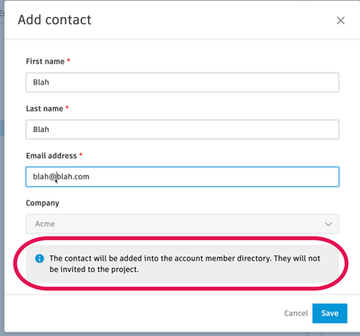

You can load contacts from account directory or add new contacts to the company if you need to. Note what is says in the red shape
That's it. They won't be invited to the project and you can interact with them for cost workflows via email!
