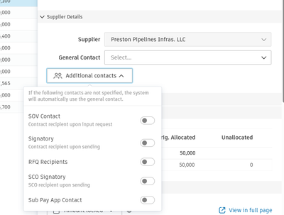

I talked with you about this at AU 2025. Would like to see the default list of e-signers for subcontracts (suppliers) expanded to included all the "additional contacts" from the supplier details section:
Also, we would like "Additional contacts" concept added to the Company Setup Section in Cost Management Settings for at least the Owner, Contractor, and Architect Sections. Then apply these to the default list for e-signers.
We often have several people who need to initial and/or sign documents at different times and adding person or role doesn't always work.

Please can you provide a list of the contact roles you would like to see for Owner, Contractor, and Architect Sections?
relleumk
@ian_turner,
I think the below list should be a good start, but I would do some more research.
Owner Signatory - Person who might need to only execute the original contract documents
Owner Main Contact – Person who would be signing CORs / OCOs for remainder of project
Owner Pay App Contact – Person who might be reviewing Pay App submissions
Contractor Signatory - Person who might need to only execute the original contract documents
Contractor Main Contact 1, 2, 3,etc.  – Person(s) who would be signing or initialing SCOs, CORs, OCOs for remainder of project. Multiple might be nice since some large projects have different PMs for different scopes
Contractor Pay App Contact – Person who might be reviewing Pay App submissions
Architect Signatory - Person who might need to only execute the original contract documents
Architect Main Contact – Person who would be signing CORs / OCOs for remainder of project
Architect Pay App Contact – Person who might be reviewing Pay App submissions

Having main contact 1,2,3 etc doesn’t really work. You could use project specific roles for that purpose.
We have a similar concept for RFQ recipients where you can assign multiple but it means they will all be notified if you send an RFQ out, but only the first will be used for e-signature.
We’re good with the concept of adding more contacts for the GC/Owner/Arch but if they are hard coded I think we need clear defined contact types for e-signature so they mean the same project to project, similar to what we have for supplier contacts.
Can you suggest some defined contact types rather than generic 1,2,3?
