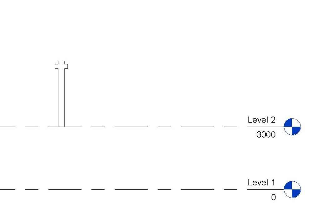

hi,i am amirul, i just anything to bring it down to the level,but the column stuck at the second level,and i just keep trying the view range to replace the rebar but it never appear the cut of the view renge. please help me.
