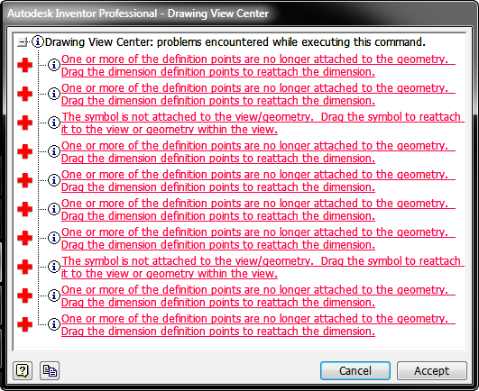

Orphaned dimensions and broken constraints give you a dialog box that you have to accept or you can not do anything else (modal). It would be nice if the error box stayed open (or you could tell it not to prompt again this session) but allowed you to keep working and fix the problems (non-modal). The list of errors would update as you fixed them.
I know! Stop yelling at me!

When you accept dialog box with some 'errors' and then fix one of them, dialog box pops up again with the rest of them. So, even if i replaced model reference and need to arrange 15 dimensions, I have to accept it 15 times!!? This process should be a lot less annoying.
The idea with dialog box that stays open while I fix errors and they dissapear from the list is great.
Same goes for errors for other features (ie. constraints in assemblies)

Even with the raido button checked in "Application Options" > "Prompts" > "Do not show messages for pre-existing problems", the stupid dialogue keeps popping up for a lot of stuff.
This problem causes RSI and wastes time.

Hi Autodesk, please add a "Recheck" button in this dialogbox. As there is in the Vault ADMS installer. Then we can work true the model until it is completly fixed.
