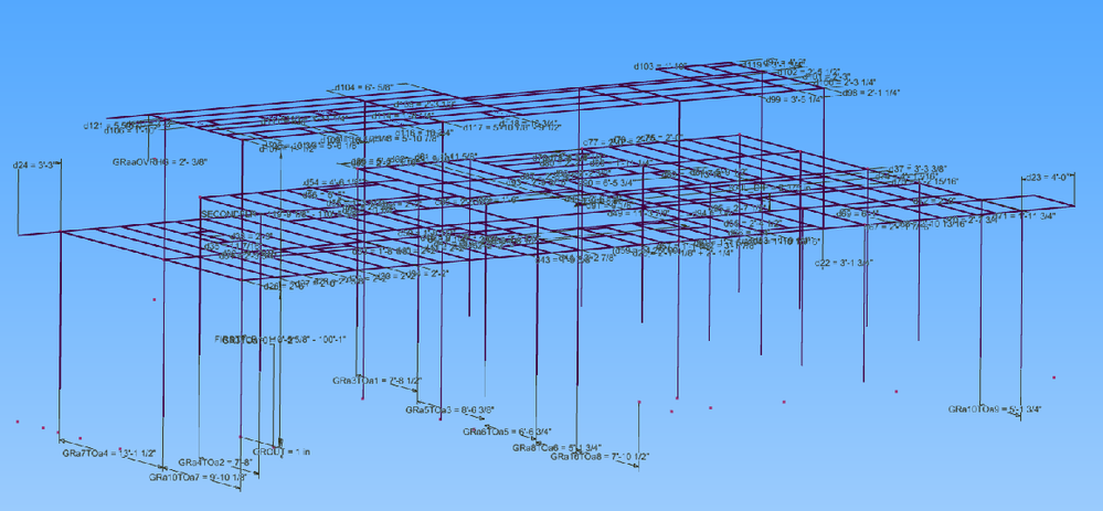

Hello all,
We use Frame Generator a lot to create frames for our equipment supports as well as access platforms, etc. Most of the time these platforms are relatively small (20'-0" square or less, usually). I am working on a design that has multiple pieces of equipment and the access platforms are all going to be tied together into one larger frame.
I created the skeleton idea for what we need using sketches and I was thinking I would use FG for the whole thing. The sketch looks like this:
I occurred to me after I got this far (it's not complete yet but it's close) that I may be completely nuts.
Has anyone ever done anything this big in Frame Generator before?
We need to create AISC/NISD compliant fabrication drawings of each piece and we usually use some other company's software to do this but I HATE that program and I want to get rid of it completely. My ability to do that depends on whether IV can handle something this large and remain stable. Any thoughts, workflows, etc?

Though our frames are not that complex as what you are showing..   I would recommend that you break up your overall structure into small manageable frame generator assemblies and then create another top assembly where you assembly all the smaller frame generator models.   In our testing of frame generator many years ago we realized real quick that creating one large frame skeleton was very confusing and time consuming to create and manage.

As has been suggested I use many sub assemblies each holing a frame generated frame to reduce each frames complexity.
I find it useful to use one part file as the skeleton for all sub assemblies and place that part into each sub assembly constrained to the origin.
That way all form edits are done in one part file and propagate into all sub assemblies.
In the attached each colour was a sub but driven by one skeleton
I find the tricky part is creating adaptive connections, the best solution I have so far is to use bolted connections at the lowest level in the browser tree possible (with no fasteners) and set auto solve on (with a shortcut key). This works very well but can chew up some processing when you cant avoid many bolt conn's at the one level.

This is typical of frames that we build with FG all the time, they can be up to 12' x 40'.  We generally break them down into sections to simplify both the modeling process, and the drawings.  Easier to weld up in smaller sections and then assemble.  We do not (at this time) use bolted connections on our frames... but we're looking into it.

I forgot to post the result when I was done with this. Here it is:
Over 1000 shop fabrication drawings and 50 design drawings later, it's done.
Frame Generator worked great. I split this up into phases as suggested so I was working with more manageable assemblies as I went. In the end it has 6,000 parts and my computer handles it nicely with no LOD's or memory management workflows. It takes about 20 seconds to open but it works great. By far the biggest structure I've done with Frame Generator.
The model with all the equipment and mechanical looks really cool but I can't show you that one Smiley Wink.
Thanks to everyone for helping me make this a success and giving me the confidence to try this with FG in the first place! Normally we use a different program for this.
