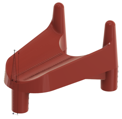

Part 1: I've just imported a .STL file from the grab cad community website. I'm having trouble figuring out how to select only the extruded text in the mesh body. no matter which way I try to select only the text portion, it selects the entire object.
Part 2: My final goal is to select the text and change it to read differently. Is this possible for text that has already been extruded?

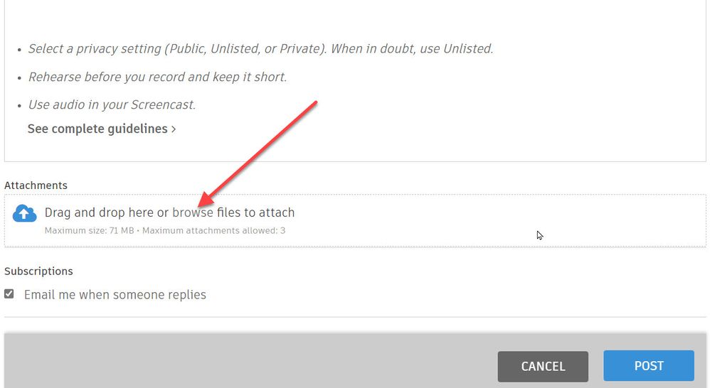

You will need to zip up and attach your STL file so the forum users can troubleshoot if for you.  STL files are very hard way to work in Fusion 360, you would be better off working with them in Meshmixer.  If you do not know how to attach your model, open it in Fusion360, select the File menu and then choose Export and save the .F3D file to your hard drive. Then use the Attachments section of a reply forum post to attach it.
