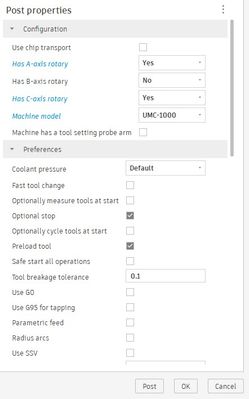

which Haas post processor is best to use with Haas UMC1000

The Haas NextGen post is probably the best. It has a machine model for the UMC line built in (there is a drop down in the configuration section of NC Programs). disregard the rotary selection in the image below, this will be different for a UMC.
