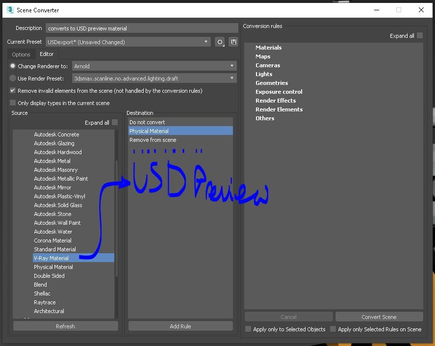

Hi @jon.bell , I wonder if I could add something onto this?
The 3ds max 2022 scene converter does not appear to have a xxxxxx to USD preview mode. When I tired to create one, I was unable to add USD preview material to the list of converted materials. As USD implementation is still in development, perhaps this could be added. We are looking at replacing our entire asset pipeline with render agnostic materials. Capture.JPG
