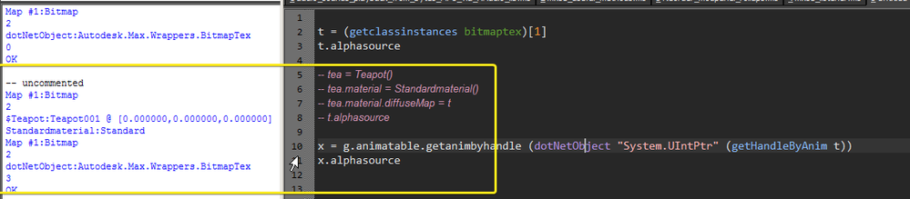

I took a screenshot showing it all:
Message 10 of 20
Serejah
And all of a sudden I can reproduce it

Now about your case. I could reproduce the problem you have! But I'm currently using MAX 2020+ and the problem is now "half" fixed, at least for those versions.
the MXS alphaSource value is shown as current on first load, but the SDK value shows 0, where it might actually be something else.
What version of MAX are you using?

Serejah
It is the BMSampler::Init method that is responsible for setting up the value when MtlEditor opens up. Not sure if there's any workaround
upd:
g = (dotNetClass "Autodesk.Max.GlobalInterface").Instance
tex = (getclassinstances bitmaptexture)[1]
format "1: %\n" tex.alphasource
a = g.animatable.getanimbyhandle (dotNetObject "System.UIntPtr" (gethandlebyanim tex))
format "2: %\n" a.alphasource
x = a.GetBitmap 0
x.toggleFlag 2048 -- MAP_PROXY   ((DWORD)(1<<11))
a.update currenttime.ticks (g.interval.create())
format "3: %\n" a.alphasource
and this is the listener output:
1: 2
2: 0
3: 3
I don't know anything about all of this. Not sure if it is safe & robust.
