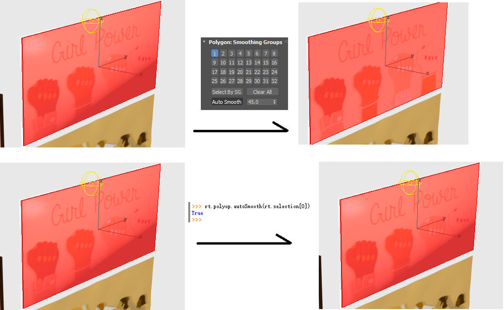

Why polyop.autoSmooth doesn't work?
adamhahaEU2VH
281 Views
1 Reply
adamhahaEU2VH
autoSmoothThreshold property is default 45
The polygon button in the element does work
very strange
282 Views
1 Reply
Reply (1)
adamhahaEU2VH
I have some new discoveries, I found that all elements need to be selected for this to work
