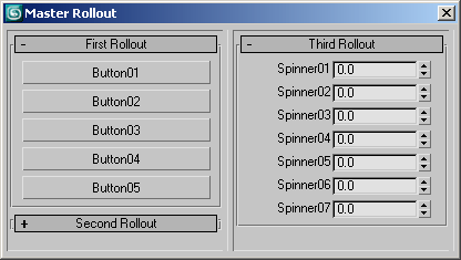

Here is a repost of my CGTalk example just for reference...
global masterRollout
try(destroyDialog masterRollout)catch()
rollout childRollout01 "First Rollout"
button btn_button01 "Button01" width:170
button btn_button02 "Button02" width:170
button btn_button03 "Button03" width:170
button btn_button04 "Button04" width:170
button btn_button05 "Button05" width:170
rollout childRollout02 "Second Rollout"
button btn_button06 "Button06" width:170
rollout childRollout03 "Third Rollout"
spinner spn_spinner01 "Spinner01" fieldwidth:80
spinner spn_spinner02 "Spinner02" fieldwidth:80
spinner spn_spinner03 "Spinner03" fieldwidth:80
spinner spn_spinner04 "Spinner04" fieldwidth:80
spinner spn_spinner05 "Spinner05" fieldwidth:80
spinner spn_spinner06 "Spinner06" fieldwidth:80
spinner spn_spinner07 "Spinner07" fieldwidth:80
rollout masterRollout "Master Rollout"
subRollout sub_rollout01 width:200 height:200 across:2 align:#left offset:
subRollout sub_rollout02 width:200 height:200 align:#right offset:
on masterRollout open do
addSubRollout sub_rollout01 childRollout01
addSubRollout sub_rollout01 childRollout02 rolledup:true
addSubRollout sub_rollout02 childRollout03
createDialog masterRollout 410 210
Follow the link for the result:
http://www.scriptspot.com/bobo/stuff/forum/twocolumnsrollout.gif
