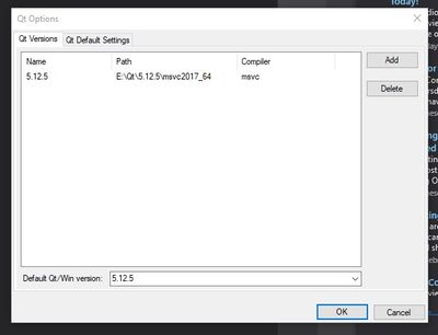

After installing the Qt tools, go to Qt Options and add the qt version and the path of it that you need.
like this:
And that's all it takes. Do not forget to remove any change you made already.

I send you an image and it is just 2 simple steps to use it.
1- add Qt tools for visual studio
2- add qt version you want in option
That's all it takes. Finish.
