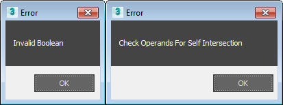

My definintion of failure is
The objects don't have any self intersecting geometry (unless ProBoolean is creating it after multiple merges).
In the occurance of the above error the 'source' geometry is deleted and the 'target' geometry becomes the result of the operation. So, you end up with one less item of geometry, breaking the 'count' workaround.
