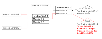

I need to traverse all the texture faces, and find out which material they were using.
After reading the doc about MaxScript, I can only access the material ID of a face. However, If this material ID points to a MultiMaterial, I am not able to find out which material it is using.
I also draw a figure to help clarify my question (and hope it works...).
The arrows from Face1 and Face2 means the material that they are using.
The arrows from MultiMaterial means the sub-materials.
I am also wondering if this material (the MultiMaterial_1 above in figure) is legal. In my understanding, a face can only have one material ID, and there is no sub-material ID. Therefore, which standard material that Face2 is using cannot be identified...

Vicent_Chen
Thanks for your reply, your script works well and successfully detects sub-materials.
It seems that my previous post was not that clear... Here is what I occurred:
Now I can only access the material ID of a face. However, If this material ID points to a MultiMaterial, I am not able to find out which material it is using.
I also draw a figure to help clarify my question...

I think the arrows in your graph should point in the opposite direction if that means the direction of the connection (dependency).

Vicent_Chen
Oh... I updated it.
The arrows from Face1 and Face2 means the MultiMaterial they are using.
The other arrows mean the sub-material relation.
Face1 and Face2 use the MultiMaterial_1.
MultiMaterial_1 has 2 sub-materials: Standard Material 1 and MultiMaterial_2
MultiMaterial_2 has 2 sub-materials: Standard Material 2 and Standard Material 3.
I am not able to find out which material Face2 is using, because I can only access its materialID(which is 2, and I can only know it is using the MultiMaterial_2).

denisT.MaxDoctor
if you know the face material id, you can get the applied material... different materials per face material id only make sense when a multi-material is applied to the object. When multi-material is sorted, the corresponding materials are applied to the face with the identifier:
getsubmtl object.material id
if the multi-material is not sorted, you can search and find the id in the materialIDList of the material.
k = finditem object.material.materialidlist id
getsubmtl object.material k
in your case a multi-material 2 is applied to face 2. The multi-material out is always the first sub-material (as I know).
getsubmtl mat 1
