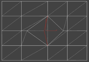

@denisT.MaxDoctor That will work most of the time, but not always, for example for the face right to the two selected edges:
It will report poly 17 which is to the left of it (you can check in the attached scene). And this is a 'proper' quad-only mesh, happens even more often with imported meshes/booleans with large ngons.
Message 6 of 10
Swordslayer
That can be mitigated by checking if the collected poly numberSet is bigger than one, getting the reverseEdge of the invisible edge, and by that the neighbor face, and intersecting with the neighbor candidate polys. Provided that the degree of the poly in question is bigger than three, that is... If not (very low chance of that, of course), this approach still won't work.
