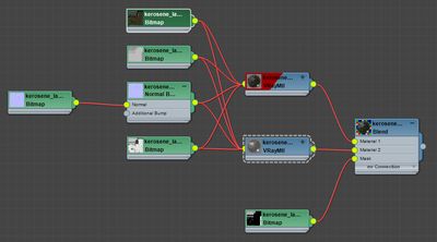

I need a solution to get all material/texture nodes connected to the Output of certain Texture or Material.
Material class has methods getSubMtl and getSubTexmap which returns all materials and textured connected to material. But I wonder why it don't have a method for getting output connections.
For example I have a Bitmaptexture which is connected to diffuse slot of material1 and diffuse slot of material2. How I can get this material objects?..

It works but collets all the nodes which are higher in hierarchy. But I need only nodes which are connected to this texture (or material)
map = meditMaterials[1].map2.texmap_diffuse
dependentMaterials = for r in refs.dependents map where isKindOf r Material or isKindOf r TextureMap collect r
for i in dependentMaterials do
	print i.name
kerosene_lamp_body_Diffuse_map:Bitmap
#(kerosene_lamp_body_metallic_mat:VRayMtl, kerosene_lamp_body_mat:Blend, kerosene_lamp_body_dielectric_mat:VRayMtl)
2 vraymaterials and 1 blend material are in dependentMaterials , but Diffuse bitmap texture isn't connected to blend material....
is there any way to filter refs.dependents result so it will return only nodes which has direct connection the node?...

But I if there any easy and elegant way to find to which texture slot output connection is connected? (is it diffuse map, or reflection, or maybe it's connected to mix texture map color 1... )
Swordslayer
Since it's going through all the slots anyway, it's easy to save the slotname in the same pass...
fn isSubTexmap m ref &slotName is:false =
	for i = 1 to getNumSubTexmaps m where getSubTexmap m i == ref do (slotName = getSubTexmapSlotName m i; is = true)
	return is
dependentMaterials = for r in refs.dependents map where isKindOf r Material and isSubTexmap r map &slotName collect dataPair val:r slot:slotName
