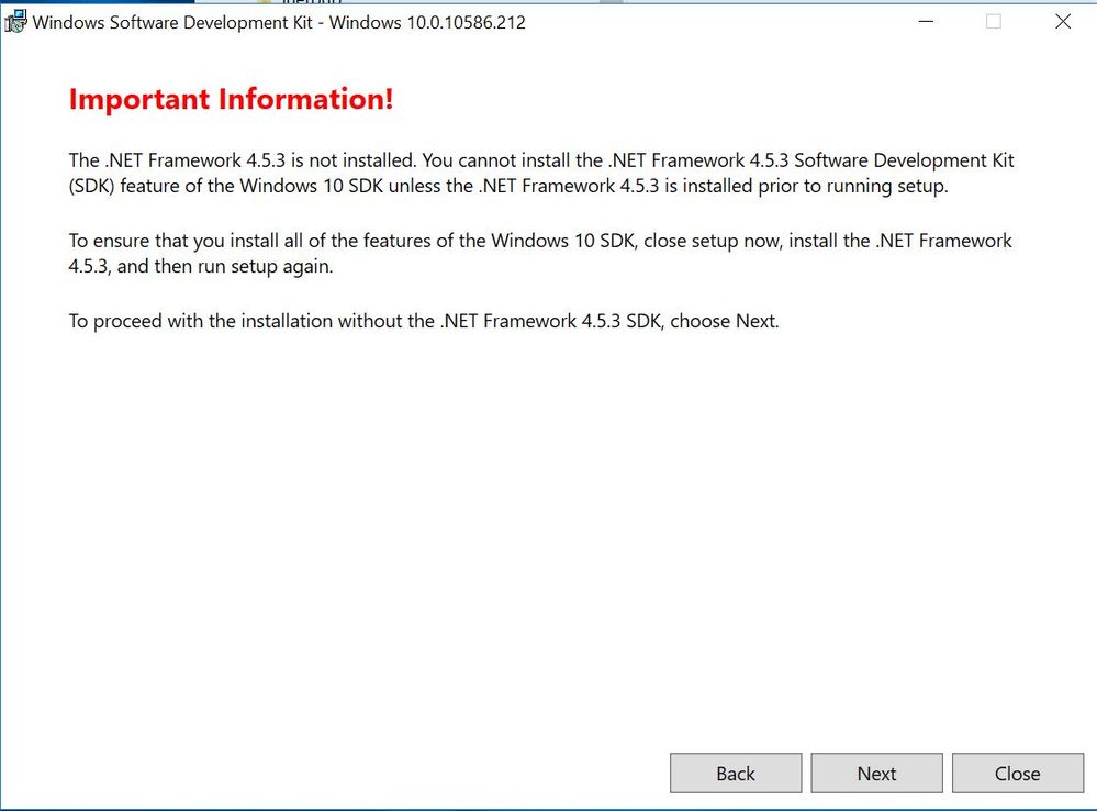

       The problem that I couldn't install the SDK10586 onto my computer was still not resolved, but 3ds max SDK wizard project item needs this target version of Windows SDK 10.0.10586。
       I met double difficulties:
       The first: I couldn't find out the framework4.5.3 on internet;
       The second: I couldn't install Windows SDK 10.0.10586 indeed. Who can help me to get and install framework4.5.3 and install Windows SDK 10.0.10586? thank you very much!target10586.png
                                                                               the error: MSB8036windows SDK10586 FW4.5.3.JPG
                                                      When installing SDK 10586, Impotant Information occured,  asked to install framework 4.5.3
                             Windows 10 SDK 10.0.10586 : The installer failed. Fatal error during installation. Error code: -2147023293
    Oh, my god. I resolved the problem with lucky.
    The method is:
     When you are installing the SDK 10586, just at the moment of installing process access to 100%, ctrl+alt+delete and end the installer process to avoid to rolling back. Thanks to myself, so great and convenient method I could invent. hahaha.....
