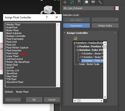

Thank you for the help so far 🙂 The next bit I don't want to get wrong as I'm not very good at scripts. I have attached two images.
1) Can I confirm that the scrip controller goes between the two objects in my image as an example?
2) Do I use a Float Script on X Rotation ?
I want to do this a bit at a time. Hope this makes sense.

1. select b6_cam_exhaust
2. in motion panel select and right click its rotation->z_rotaion
3. assign a float script controller
it opens the script controller dialog
3. Create xrot variable
4. Assign Track:
CAM_DRIVE_DUMMY -> rotation -> x_rotation
5. add expression - degToRad (1.05 - xrot)
6. Evaluate
7. Close
that's it

OMG! It worked!
Denis, do you realise who many months I've been trying to solve this problem. At least 6 months!
I am so grateful, thank you so much!
