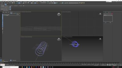

From lots of experience using AutoCAD I know that going into a specific viewport will constraint your movements (logically) to the axis you can actually see. So I simply go into the Top viewport to draw a line on the X axis there and I can't. I keep going down the Z. Why? And how can I draw on whichever Axis I like? So much for the Enable Axis Constraints option. It's moments like this where I think i'm getting trolled by the software. Here's a screenshot. And yes, I know i'm not in the top viewport in that moment.

In AutoCAD and 3ds Max you typically do NOT draw on a axis but draw on a plane.  Similar to AutoCAD, in 3ds Max screen picks  are projected to the XY plane (unless otherwise affect by snaps).  The active XY plane depends on which coordinate system is active -- view, local, world, etc.  You have to be careful when  you are in an "orthographic" view (not to be confused with a front view.  In this case the XY plane may be perpendicular to your viewing directions and screen picks cannot be project to the world XY plane.

But THIS is ridiculous. RCS doesn't change depending on my settings. If i'm in the Right view and it's set to VIEW... It isn't that. I still see the RCS icon on the bottom left without the proper axis orientation relating to my setting. It SHOULD be working.

the second image indicates that you are using the "pick" coordinate system.  I am not familiar with it and have never used it.  How do you think it should work?  I would use World or View.

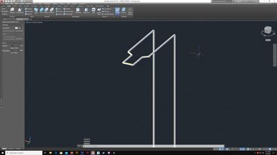

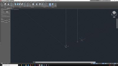

I recreated the part in AutoCAD more or less perfectly. If I had spent more time it would have been identical. But it's just to show the differences in the software and what I would want to achieve. Minus the torus parts going up vertically, that part is very simple.
In this specific instance I would like to know how to model something like this. And Max's Reference Coordinate System is either just buggy for me, I don't understand how I should be using it, or it's incredibly unintuitive and borderline useless for this. In AutoCAD, much like Max, you can change the UCS (RCS for Max) to your current view. And drawing primitives - anything used in 2D drafting really - is also done on the XY plane, just like Max. Except changing the UCS to view is as easy as selecting the desired view from the view cube and using the UCS command, View. And the software responds accordingly. Very intuitive, very responsive and useful when modeling.
Here you can see I start drawing part of the metal piping/wiring. The part that goes vertically along the toilet paper thing and then goes ACROSS the XY axis. I drew that on the XY plane first.
I drew the two vertical parts and the switched the coordinate system back to default, you can see that in the end result.
 A circle of desired size is drawn on the XY plane in the same orientation as the bottom of the solid cylindrical structure. Then a sweep command is performed with the path that has been drawn as the sweep path.
 And there is the result. Mint.
From another view.
So I know this is Max we're talking. I'm just trying to show how i'm thinking when I'm modeling. And I would love to see someone create the toilet paper thing in Max because it would address this. I believe the main issue here is the wonky RCS. And perhaps i'm getting ahead of myself with Max? I want to learn as much, as quickly as possible. The transition between the two software in regards to UI and navigation is a breeze. A lot of familiarity there. Some things for the developers to consider are familiarity in points of reference. But that's just me. The overall idea shares a lot of the same context. But... functionality? Errr... Yeah. I don't know about that.
Regardless, I appreciate the screencast still. But I would like to know ultimately what I should be learning next? Perhaps I jumped the gun. I have followed some video tutorials on modeling a table. What do you recommend is next for me?
