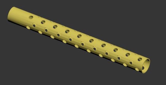

So I started modeling a Browning M2 the other day, and I realized that dealing with the holes in the barrel (for heat dissipation) is way harder than I thought about for 3D modeling. I tried using Geopoly to make the circular holes, but the topology was all messed up after that, and it didn't look like a cylinder anymore. The closest thing that I got to work was the ProBoolean option with a cylinder. I was able to section off the booleaned part and duplicate it four times to get a circle on the top and bottom, as well as both sides. The head sinks in the gun however, alternate. They aren't all in a row. The second set is offset diagonally. I did the same thing, and while it was successful, to get the topology to work properly, the vertices no longer line up.
I wanted to get some input. What method would you guys suggest for creating something similar to the barrel that is in this image?

You can use the array function twice to create a collection of cylinders that can be subtracted from the barrel with Pro Boolean.  In the image below I positioned one cylinder just up from the base of the barrel then used array.
The next step is to position a cylinder 45° and halfway up from the first and array it (with one less in the barrel length direction).
Here is the result.
